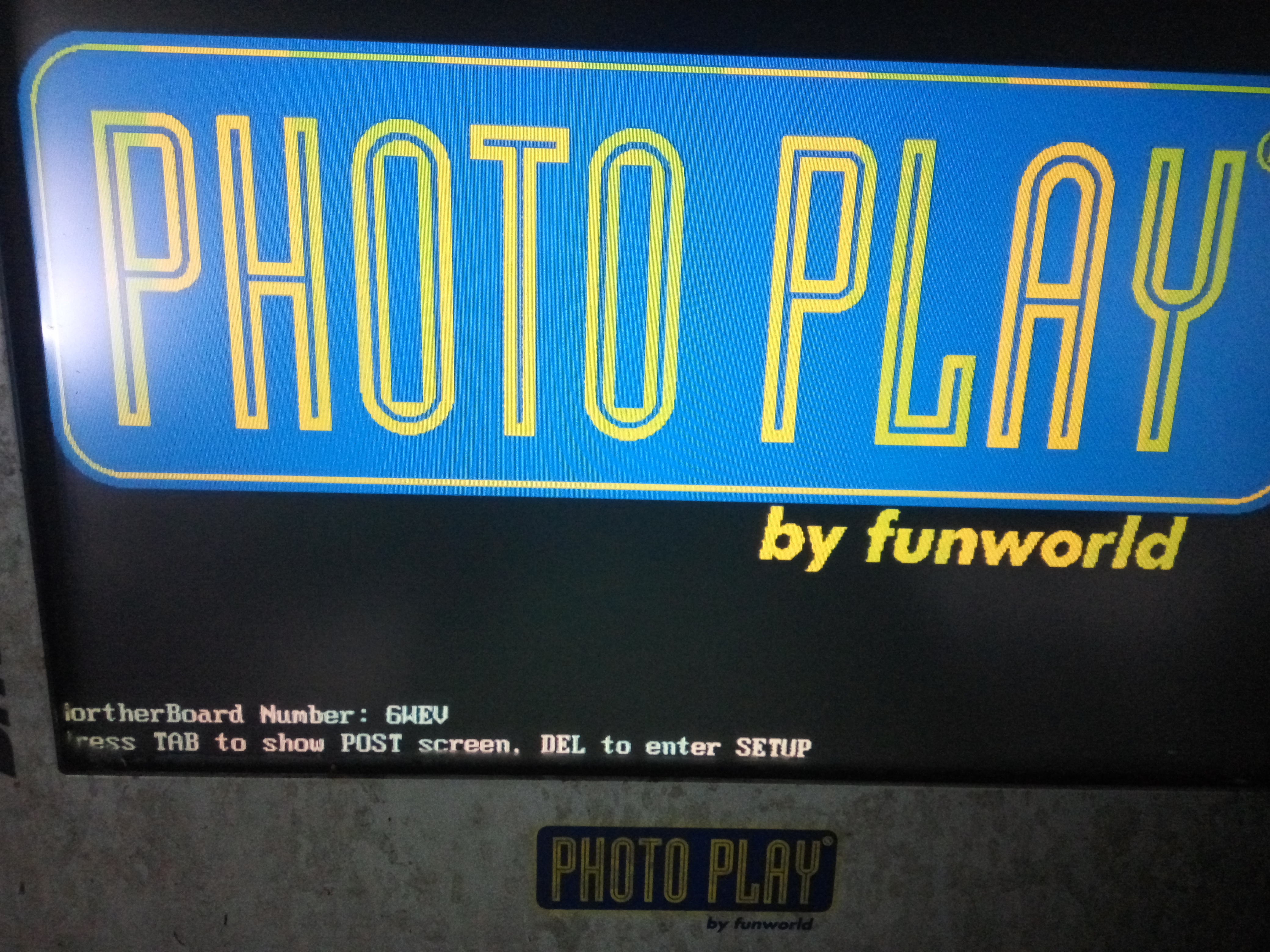

gizaha 9 november 2013 gepost Auteur 9 november 2013 gepost Hello again! Pleasant to meet you. I have the sprint 2.1 with 6WEV motherboard. I try to update to version IGO7 and i knew almost all of these you said. I'm not sure what program had the first hard drive (the broken one), but i didn't knew that dongle is for specific version. You mean if it had the IGO3 it will NOT run with IGO7? The usb dongle is gray, do you know from which version is? Are you sure about the connector on the front of the system? I didn't find anything, but i will check again today for sure. Quote

djkoelkast 9 november 2013 gepost 9 november 2013 gepost Sorry I misread there, I have the Spirit 2.1, the larger version. I think the Smart can not run IGO versions, because the touchscreen doesn't have DOS support I guess (as I don't own a smart I can't be 100% sure though). Then just look for a 2nd IDE port on the motherboard, that's where you can connect your DVD player/burner. You might need to add a cable yourself. Quote
gizaha 9 november 2013 gepost Auteur 9 november 2013 gepost (aangepast) I spend all my day with no luck. The previous owner said that the previous falty drive had the 2007 version installed (not specify what kind of "2007") IGO7 means 2007 or am i wrong? I found some pages on the internet like this http://www.arcadoman...lay-Smart-21/en so i believe that this smart 2.1 can run the igo7. Correct me if im wrong. *First try: Opened the case, connect an ide cdrom and the hard drive on the same ide cable and connect to motherboard. Result: No boot, error "bad or missing command interpreter". Tried only the cdrom without the hdd, the same. Tried some master/slave jumper settings, the same. Tried another ide cdrom drive, same. *Second try: connect both the cdrom and the hard drive to a pc. All procedure ok, cd boots fine, partitions the hdd and copy files. Then i put the hdd to the photoplay, "cannot find mbr" error. This applies when i had the hdd ntfs formated before booting from cd. When i format hdd to fat32, it gives error like no having disk at all. When i format the disk to fat (fat16, 4gb partition) it gives cannot find mbr. I can't think what's wrong. From my point of view, there are these chances: Bad hdd. I give him some test, some checkdisks, i believe that if it had some errors, it would give some error sometime. Bad cds. A bit unlikely, looked perfect, burn them yesterday. Again, if there was a problem, it would give error in update procedure. Some ideas? ps: on http://update.photoplay.com/photoplay/dvd/old/ what's the difference between the igo7 version, and the "update 2007" version? update 2007 looks xp version (XPO_OTS04.00.rar) should i give it a try or it would have a dongle problem? I'm still not sure from what year is the usb dongle, is there a change that this machine would had XPO_OTS04.00 version? 9 november 2013 aangepast door gizaha Quote
djkoelkast 9 november 2013 gepost 9 november 2013 gepost Update 2007 is the DVD version of XP, you'll need that one if you have the USB dongle. You'll need a bigger HDD, I would install a 20GB drive, not a 4GB, it's not enough. To install the DVD drive should be on the 2nd IDE port, not together with the harddrive. http://www.medi-gmbh.com/images/Mainboards/maxi/6wev.jpg If your HDD is on the blue, use the white one for your DVD player. CD-ROM will not work as the update 2007 image is a DVD. The USB dongle, has it a sticker on it when you take it out? It should be a small metal dongle with a small sticker on it. Quote
gizaha 9 november 2013 gepost Auteur 9 november 2013 gepost (aangepast) HDD drive is 120gb, just the partition the photoplay create is 1.48gb. When i create fat16 partition it didn't allowed me to do bigger than 4gb. I used CD drive, not dvd drive, since igo7 is 2 700mb isos. I tried already as you said, cd rom on the white ide and hard disk on the blue, no luck. I tried cd rom on the white with hdd on it's case and default position, no luck. The usb dongle just have a sticker that sais "GR" (greek version). 9 november 2013 aangepast door gizaha Quote

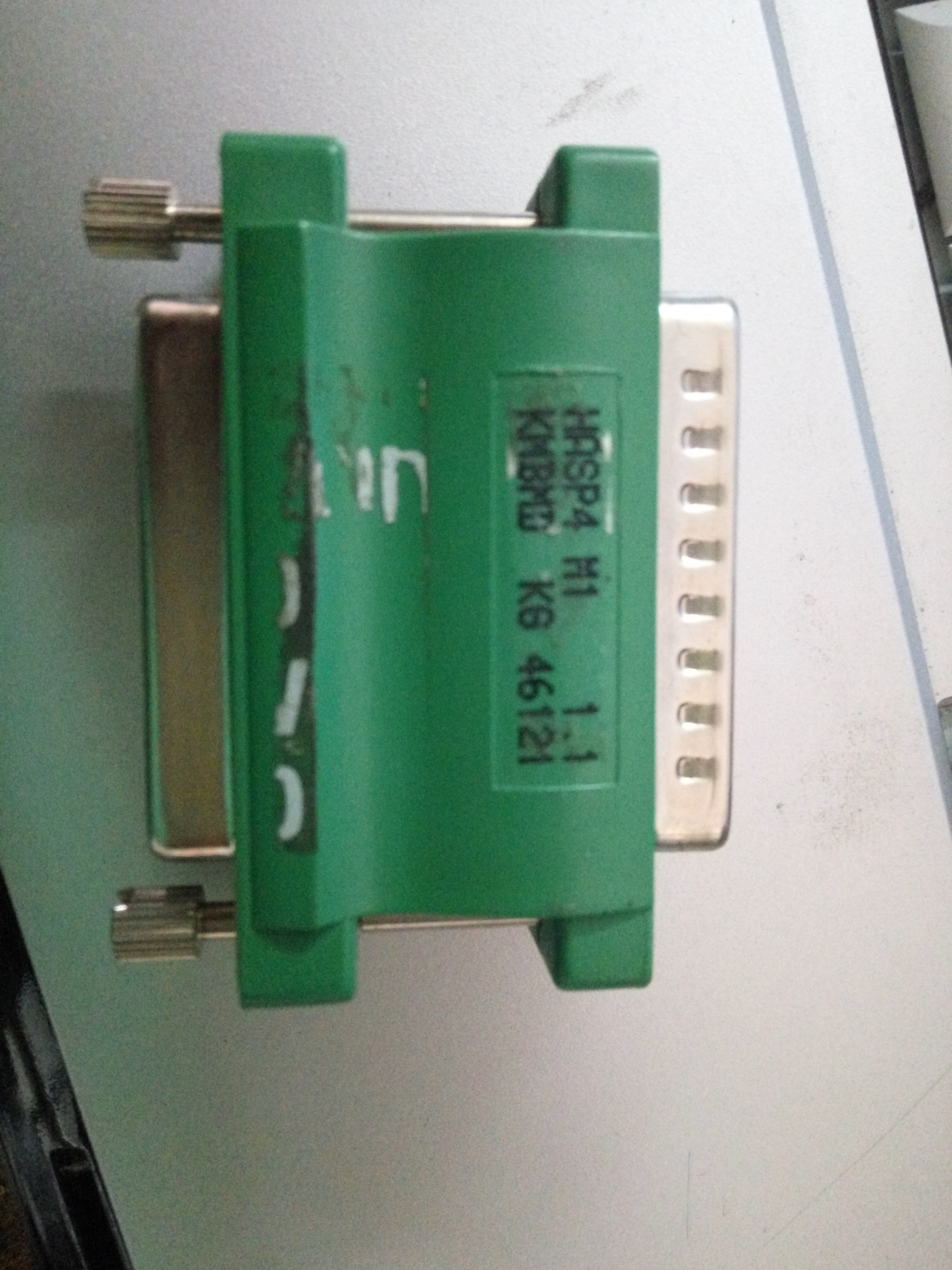

djkoelkast 9 november 2013 gepost 9 november 2013 gepost But you can't use the IGO unless you have a green 2007 parallel dongle, so stop trying that unless you have the correct dongle Quote
gizaha 9 november 2013 gepost Auteur 9 november 2013 gepost (aangepast) There is a big change that you are right, but the problem wasn't the wrong dongle but the wrong installation. Anyway, first of all i want to know for sure, for which version is my dongle, in order to try with the correct version. Since the owner told me something about 2007, tommorow i will try update2007/XPO_OTS04.00.rar Wish me good luck, any further info about the usb dongle acceptable. 9 november 2013 aangepast door gizaha Quote
djkoelkast 10 november 2013 gepost 10 november 2013 gepost Can you make a picture of your dongle? If you press the grey "Gebruik volledige editor" button on the bottom right you can attach pictures here on the forum itself. It should be an Aladdin HASP dongle, a few centimeters long, metal casing. Is there a sticker on the old HDD with a version number on it? Official HDDs come with a "Photoplay - Language - year" sticker. Quote
gizaha 10 november 2013 gepost Auteur 10 november 2013 gepost (aangepast) Problem solved. Forget anything about IGO version. It was needing xpo version, however i could not boot even with xpo. After countless tests, i discovered that the plastic hdd case was faulty. Or it's ide cable, who knows. When connecting hdd straight to the mobo, it works. ALSO i had a faulty usb dongle (i didn't knew that usb dongles could die). I put a 2009 hdd and dongle and it works perfect. I didn't knew that 6wev was compatible with 2009, and it works perfect. One thing i forgot to ask: In case of hdd failure, can i use other brand hdd, or it boots only with the "Quantum Fireball"? Does anyone tried? Other things i learned from photoplay, in case that someone needs info: 2007 usb dongle: Yellow sticker 2008 usd dongle: Blue sticker 2009 usb dongle: Green sticker 10 november 2013 aangepast door gizaha Quote
djkoelkast 10 november 2013 gepost 10 november 2013 gepost I'm using an SD-card to boot from. My Spirit 2.1 boots in 20 seconds from power off to usable. You can use any brand of disk, as long as it's configured to be master and is larger than the minimum required size. I believe IGO has to be 2GB at least, XP needs to be 8GB at least. For the color I have to look at my 2006 dongle, I'm not sure about USB dongle colors. Quote
gizaha 11 november 2013 gepost Auteur 11 november 2013 gepost I'm sure about the colors, i saw yesterday the 3 of them, with my eyes. Thanks about the hdd info. Quote

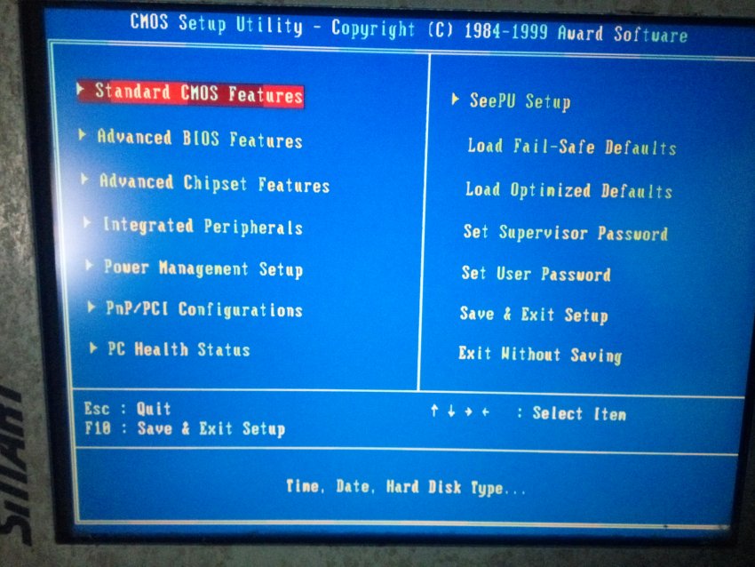

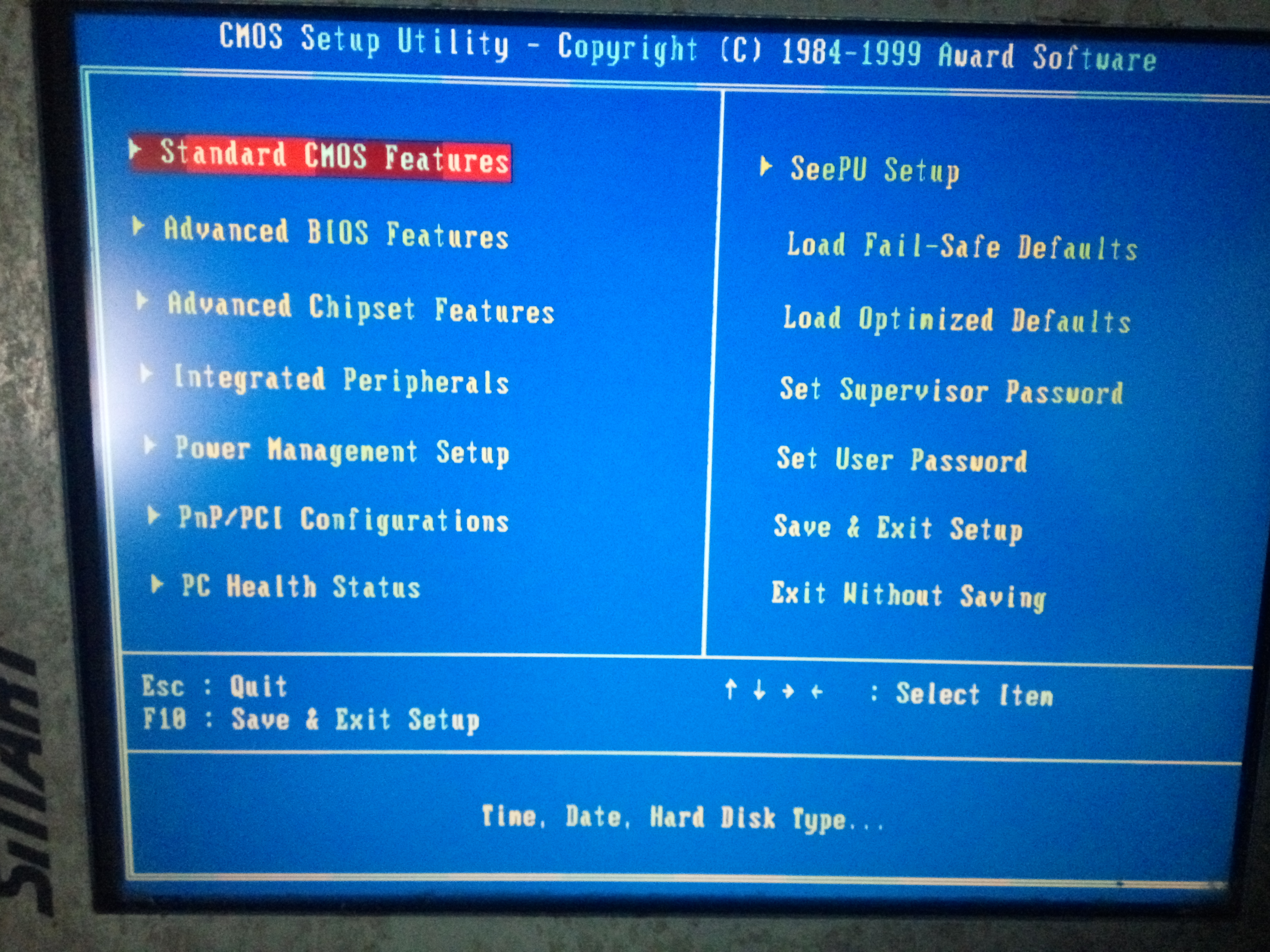

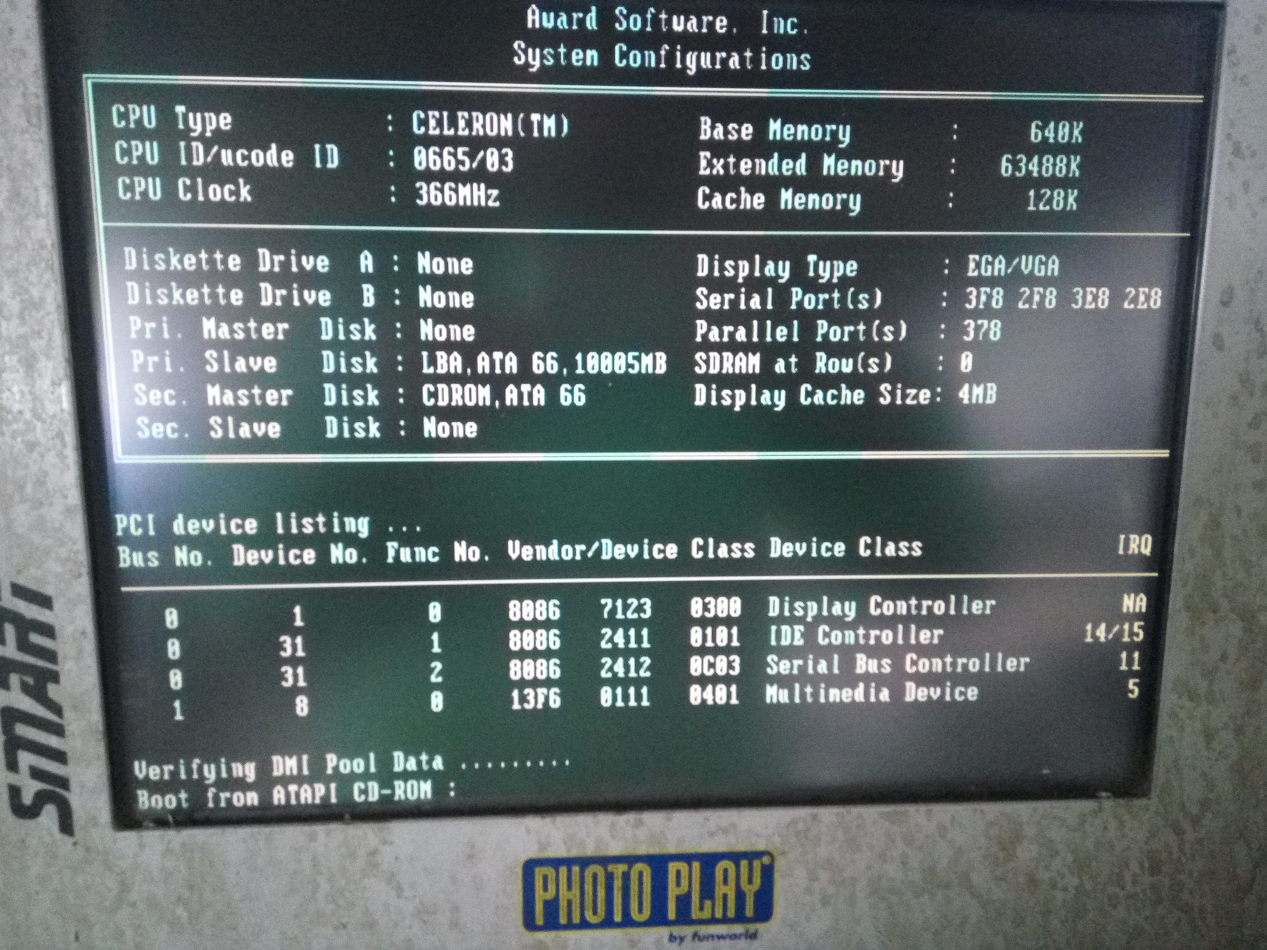

pro8 26 oktober 2017 gepost 26 oktober 2017 gepost nice to meet you,,,i have a photo play smart by funworld I.G.O ED. 1 hard disk show an error about NTLDR is missing...the dongle is green colour but they havent any stick on it to know whick country is. im from greece..plz help me to make it run.. Quote
djkoelkast 26 oktober 2017 gepost 26 oktober 2017 gepost 7 minuten geleden, pro8 zei: nice to meet you,,,i have a photo play smart by funworld I.G.O ED. 1 hard disk show an error about NTLDR is missing...the dongle is green colour but they havent any stick on it to know whick country is. im from greece..plz help me to make it run.. Welcome to Retroforum! NTLDR is missing is a sign that Windows has been tried to put on that hard drive. IGO and the parallel dongle is not for Windows, it's for the PTS-DOS version. You'll need a different hard drive with the correct software or reinstall the software with the correct cd and the copybox from Photoplay (which is quite hard to find and quite expensive). Best thing to do is find a harddisk with corresponding dongle online, that's the cheapest and safest option. Quote
pro8 26 oktober 2017 gepost 26 oktober 2017 gepost thank you for your soon responce... will not work?it works but for unknown causes show erros. i put external cd and i try some edition to install but show me another error "bad or missing command interpreter" i will upload some pic..pleaze there is a case to work? Quote
pro8 26 oktober 2017 gepost 26 oktober 2017 gepost Can you tell me the total procedure to reinstall the software? Where i connect the cd rom? Is it autoinstall?? Any diffferent setting in BIOS?? There are only two greek versions for smart photoplay and i downloaded them.. Now what?? PLS Help Quote
djkoelkast 26 oktober 2017 gepost 26 oktober 2017 gepost 36 minuten geleden, pro8 zei: Can you tell me the total procedure to reinstall the software? Where i connect the cd rom? Is it autoinstall?? Any diffferent setting in BIOS?? There are only two greek versions for smart photoplay and i downloaded them.. Now what?? PLS Help You'll need the Photoplay installation box. And connect it to your Photoplay computer You can't use Windows versions. Best bet is still: buy a second hand hard disk + dongle. From eBay or such, shouldn't cost too much. Quote
pro8 27 oktober 2017 gepost 27 oktober 2017 gepost that's what I'm trying to explain. -I placed a new hdd 40gb. -made partition and fat. -connected IDE CD ROM -Download the greek version (GR_IGO6)that version has in the old hdd but the problem is the same. what can I do wrong? Quote
djkoelkast 27 oktober 2017 gepost 27 oktober 2017 gepost 35 minuten geleden, pro8 zei: that's what I'm trying to explain. -I placed a new hdd 40gb. -made partition and fat. -connected IDE CD ROM -Download the greek version (GR_IGO6)that version has in the old hdd but the problem is the same. what can I do wrong? It only runs on PTS-DOS, you can't just start with any IDE CD ROM. Also you need the IGO6 dongle if you want to use IGO6. Quote
pro8 27 oktober 2017 gepost 27 oktober 2017 gepost 1 hour ago, djkoelkast said: It only runs on PTS-DOS, you can't just start with any IDE CD ROM. Also you need the IGO6 dongle if you want to use IGO6. i have green dongle gr and hdd in fat partition..how way can i repair it? Quote
djkoelkast 27 oktober 2017 gepost 27 oktober 2017 gepost 23 minuten geleden, pro8 zei: i have green dongle gr and hdd in fat partition..how way can i repair it? As I told before: either get the correct cd and the box, or get a different hard disk + dongle. You can't fix this in another way. Quote
pro8 27 oktober 2017 gepost 27 oktober 2017 gepost can u plz help to find a hard disk and dongle to fit in my console? *if you can't write public send me p.m. thank you very much dear!!! Quote
djkoelkast 27 oktober 2017 gepost 27 oktober 2017 gepost I don't know of any Greek, but here in The Netherlands you can find them for example here: https://link.marktplaats.nl/m1191533505 Quote
pro8 27 oktober 2017 gepost 27 oktober 2017 gepost (aangepast) upload some pic to see the details . i have got a lot of motherboards..can i do some update to run xp series????what i can do to improve..to be more useful? 27 oktober 2017 aangepast door pro8 Quote
pro8 1 november 2017 gepost 1 november 2017 gepost (aangepast) install cd-drive ide download igo 2006 gr version(2 cd) boot from cd2..install software and it works!!! no need Photoplay installation box. *so i was bye and computer photoplay spirit with udb dongle.. 1 november 2017 aangepast door pro8 Quote
